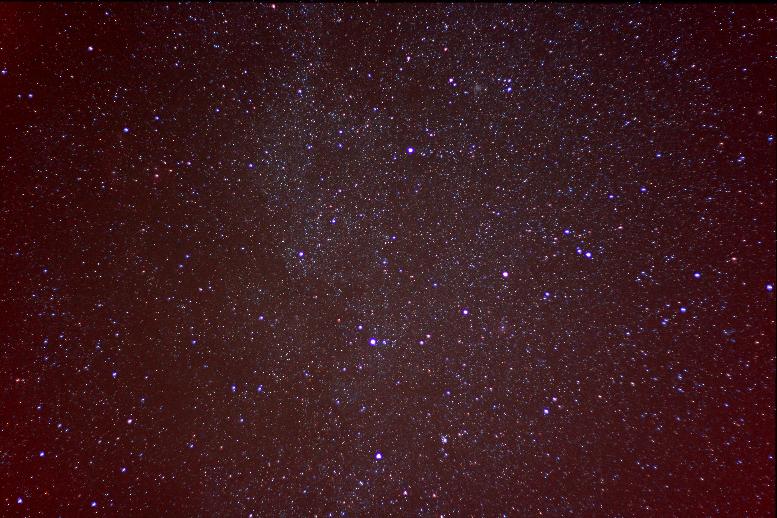

IRIS software was used to process the RAW images. Here's how the shot looks like with virtually no processing except re-sizing
This and all subsequent images are click-able to allow examination of the full size originals.

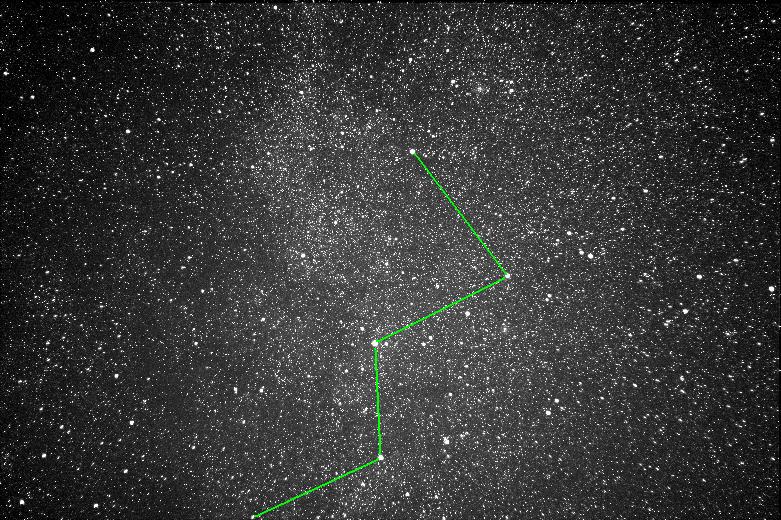

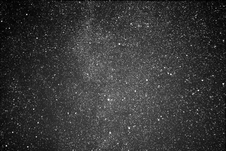

Anyway, here's the result of subtracting the dark frame from each of the four exposures, aligning and stacking the four resulting
frames, tweaking the dark threshold and applying a light unsharp mask:
Click on the image to see it at full size (2.5MB download)
The photograph is of the Milky Way in the general area of Cassiopeia which is almost overhead the UK around midnight at this time
of year. To help orientation I have drawn lines connecting the five major stars.
Apologies if the lines aren't quite in the right place. :!:

While sitting here listening to a concert by the late and much lamented Luciano Pavarotti, who I had the great privilege of seeing once at the Met, I spent a little time counting the stars in a small section of the image in my last post.
Very approximately, I think the whole image must contain around 75000 distinct stars, not counting those stars too faint to show up individually but which contribute to the glow. We now know that planetary formation is likely to be the norm as part of star birth though many planetary systems look very different to our own.

Hey, I'm not so sad that I counted all 75,000. :lol:
Yes, I inverted the image (stars as black dots) and copied out a 300x200 pixel section which seemed to have an average density. In the end I only counted the stars in a 150x200 pixel section (used "Paint" to add a small dob of red over each star counted) and then extrapolated. Thus the 75,000 figure is very approximate but at an average of one star per 133 pixels it doesn't seem wildly out.
As you know, our galaxy is thought to contain around 100,000,000,000 (100 billion) stars so even with that delicious 85mm f/1.2 lens I think any big sky pictures would come up a little short!

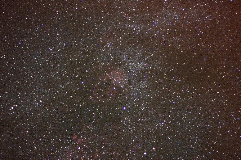

Following this advice at Christian Buil's web-site I restricted myself to ISO 400. The following shot was taken with the 50mm lens wide
open at f/1.8 with a 120 second exposure. Click the image if you want to see it at full resolution - much more detail but a 2.5MB file.
In the centre of the image is the North American Nebula (geographic north would be to the right), so named because of a resemblance
in shape to that continent (WiKi). The image has been post-processed using IRIS.
I was running a sequence of test exposures and, unfortunately, after the fifth the dear old steam age ThinkPad ran out of boiler pressure
and locked up on me so not only was I unable to expose a proper dark frame but I had to cut the session short. It would have been nice
to run some more exposures at the settings above with a view to stacking some frames. That will have to wait for another night when,
hopefully, I can correct some of the other technical defects in this image.
