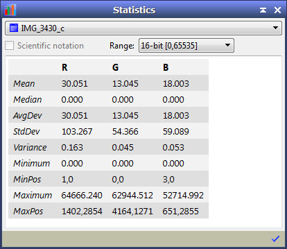

 Post subject: Re: CCD vs DSLR headache
PostPosted: Sun Apr 08, 2012 4:45 pm
Left: RAW image without bias/dark correction.
Right: Same image with correction.
Here we go, and this is also the first time I ever tried using bias and darks in PixInsight. ISO800 30 seconds on a 450D. 10 frames of each taken over a year ago, used to correct one of the darks. I wont bother with the crop since all you see when you stretch the display enough is an abstract art work, and it is the scale that is of importance.
I am wondering how to interpret the results though. I'm not sure the Mean is so meaningful, except if you need maximal detail in the dynamic range available. Given I'm heavily light pollution limited that isn't the worst for me. I think the standard deviation is more meaningful as to the level of visible noise in the image. Not sure what AvgDev means in this context though, since the value seems to be the same as Mean. Regardless, my values are quite a bit higher. Maybe it would help if I had also taken 25 of each too, which I think is 1.6x better than 10? Although I may have more proportionate benefit in self referencing here.
PostPosted: Sun Apr 08, 2012 9:26 pm
Looks like you are getting value from those calibration frames but the big question is how much? I didn't include the uncalibrated statistics for the 8 and 1500 second exposures in my original post because my purpose was to show how little thermal noise was being added by the very long exposure time to the final result. However it might make interpretation of your own result clearer if I do include them so here's the full set of four, uncalibrated in the top row and calibrated, as seen before, in the bottom row; 8 seconds first and 1500 seconds second. You can see a very significant bias signal in the uncalibrated images which makes comparing the Mean signal between calibrated and uncalibrated images pretty meaningless, if you'll excuse yet another bad pun! :roll:
A spot of Googling elicited that "image noise definition ean be axioniatically shown to be proportional to the standard deviation of an image of a homogeneous region" (reference). That fits quite well with the above statistics with the 8 second exposure already exhibiting low noise before calibration. It also illustrates quite powerfully how calibration has improved the 1500 second image with the StdDev dropping from about 121 to 25. Just numbers, of course, and as I remarked before it makes a lot of sense to combine several subs to further reduce the effects of thermal noise. Comparing the StdDev figures for the calibrated images moving from 8 to 1500 seconds increases the StdDev from about 5 to 25. Frankly I don't know whether perceived noise is proportional to the StdDev or to some power of StdDev so I'll show the histogram stretches again. For folk who didn't read the previous post the 8 second exposure on the left was given a really extreme stretch (much more than would be applied during regular processing) just so that the noise pattern can be seen. Exactly the same stretch that was applied to the 8 second exposure was applied to the 1500 second exposure on the right so the amount of noise in the two images can be visually compared.
Looking carefully at those 100% crops I suspect that perceived noise really is directly proportional to the StdDev. If so an increase in noise (thermal plus read) by a factor of 5 for an exposure change of a factor of nearly 200 is a good result. Maybe a mathematician can come to the rescue on this one as my graduate maths studies are a long way behind me and statistics was always a dark art so far as I was concerned. :oops:
I'm hesitant to try and interpret your own numbers as I'm already straying well above my pay grade in trying to interpret my own but I do note that not only are your StdDev figures higher in each channel but the improvement after calibration is proportionally much less though still worthwhile I think.
PostPosted: Sun Apr 08, 2012 11:37 pm
I think I made one minor mistake in my previous results. The bias/darks apply to the frame before debayer, so the stats for each colour channel have not been re-interpolated to fill in the gaps. I'm not familiar with the debayer function in PixInsight and it's rather late for me to RTFM, so in a blind play I picked something at random and the result from that gave more significant improvement. I wont post it yet as I'll figure out how to make sure I do it right before I do that.
