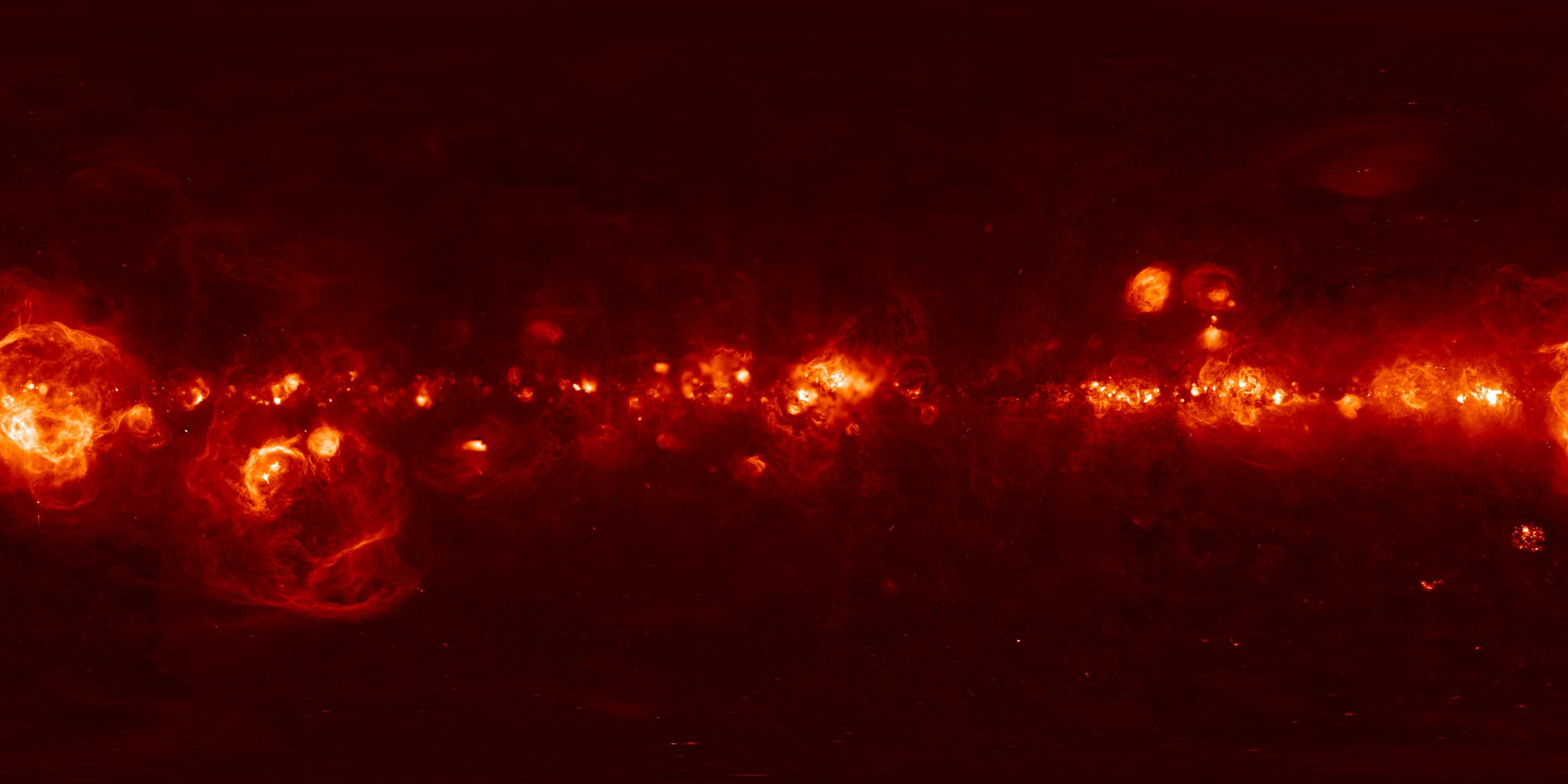

I came across the H-Alpha Sky Survey today. For some reason my poor brain needed me to flip the image and rotate it 180° before I could orientate myself properly but after doing so I saw this:
    Clickable for a larger version.
With that done the Orion Molecular Cloud complex is readily identifiable about 1/5th of the way in from the left and slightly below center and can be used as a starting point to identify other features of interest and potential targets. Of course some features will never be visible, depending on where on the planet one lives. :(
Even so I think the image is very encouraging for us Hα imagers (oh, it felt nice writing that 8)) as there is plenty to shoot at at all scales although some of the dimmer features would require a great deal of exposure time!

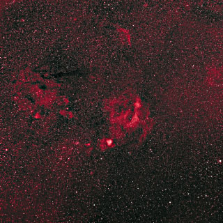

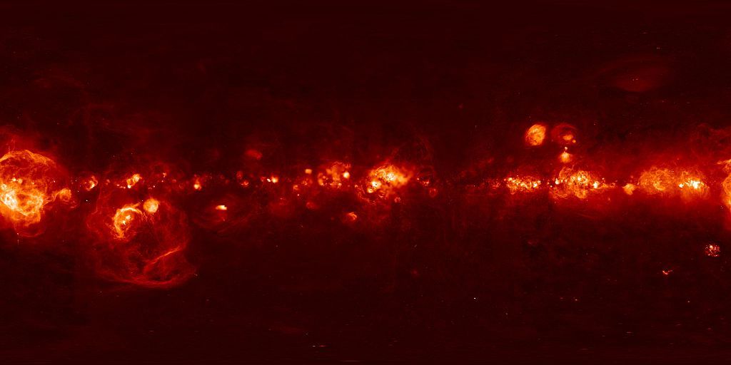

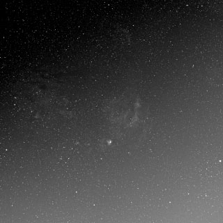

Hmm. Too close to the Moon! Background signal was high but the killer was the gradient and to cap it all cloud rolled in halfway through the first shot and then delayed the second shot by over an hour. So much for my intended 5 x 1500 second exposures but I wouldn't have done more than one once I'd seen the quality. Here are both the original and processed versions of the single 1500 second Hα that I did manage. Horribly noisy as, with one exposure, I was really scratching around trying to find the signal but I think there's enough there to suggest that, when the Moon is gone, the area would benefit from maybe 8 x 1500 second Hα exposures at f/2.8 as well as some RGBs.
    ................................................Nominally centered at R.A. 4h 00m, Dec. +52° 30m
    .Image
    ............................And here's roughly where I think it is on the H-Alpha Sky Survey.
It's difficult to identify some of the features visually but it seems pretty clear to me that, after cross referencing the position with the Sharples Catalog, I have Sharpless 205 (R.A. 03 48.5, Dec +52 54) just to the right of center and the brightest knot of nebulosity a little below center is Sharpless 206 (a.k.a. NGC 1491).
This is a thread about target planning but it's also helpful to know what you've finally got and, in addition to the Sharples Catalog already linked to above, I've just discovered the CCD Images of The Sharpless Catalog site, an invaluable resource. One might be discouraged knowing others have been there already but for most of us the journey is one of personal discovery. Just because someone has already photographed the Grand Canuon doesn't take any of the pleasure away of our doing it ourselves should we be lucky enough to visit!

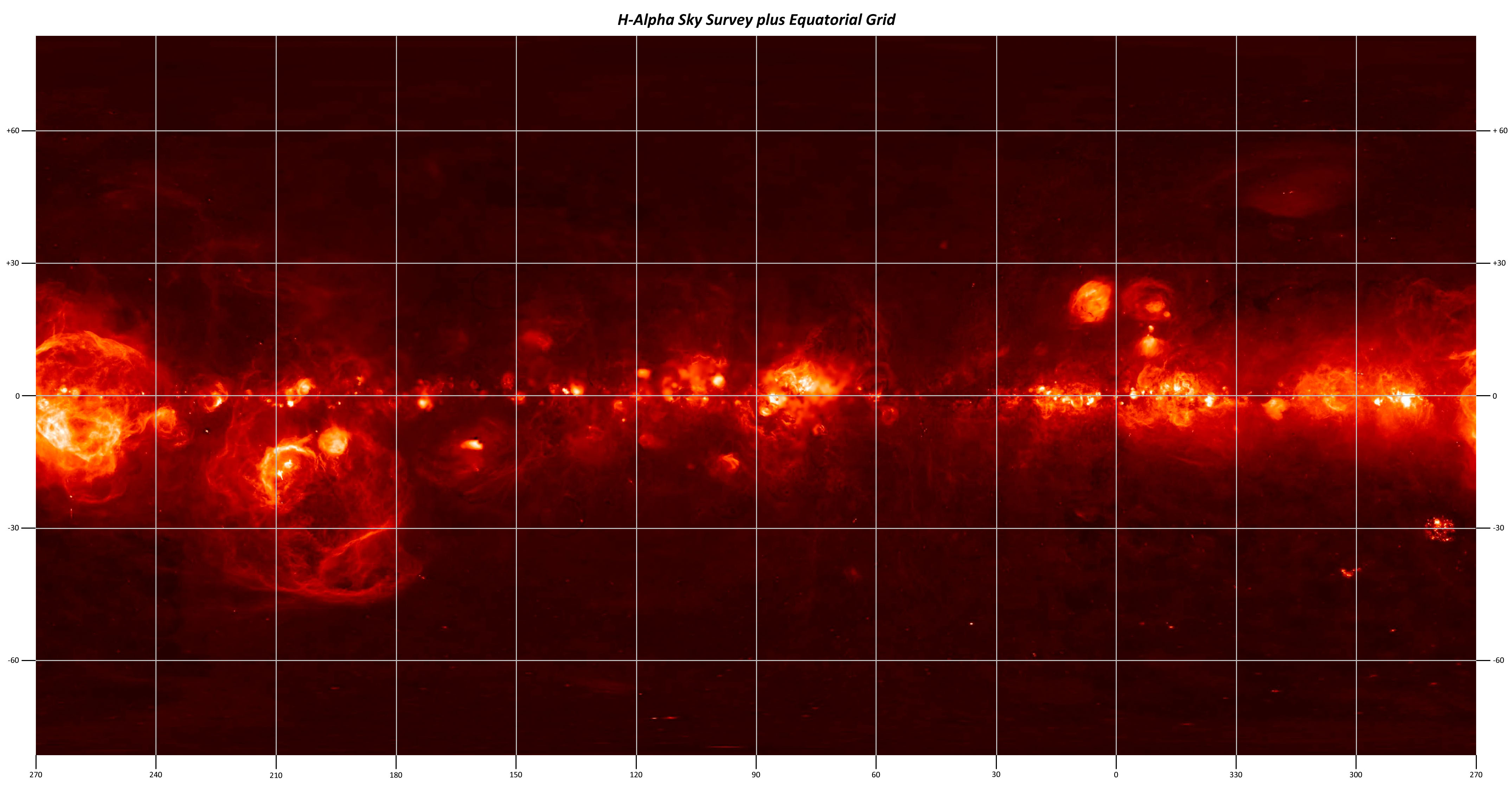

Back firmly on-topic, the Hα Sky Survey Chart isn't at all easy to navigate. So step one was to add a Galactic coordinate grid to the chart - accuracy won't be perfect but it shold be good enough. It would have been nice to add R.A. & Dec. grid lines but that would take far too much time for me to compute but their is an alternative. First the modified chart:
No, my eyes aren't that good so if you click the chart you can view and/or download a much more eye-friendly sized version. For conversion to and from Galactic and J2000 coordinates head on over to NASA's HEASARC Object Position Finder, Coordinate Converter, and Separation Calculator. It shows you how to enter coordinates in the "Object Name or Coordinates" box and all one has to do then is select the right "Input Coordinate System" from the dropdown listbox and then press the "Find Target/Convert Coordinates" button and you'll get a full list of the equivalents in the other coordinate systems. If you get a message about the system being temporarily down instead of the expected output the chances are you made a syntax error when entering the coordinates initially. Yes, I did get just that a couple of times: it can be quite picky, particularly when it comes to leading zeroes!
Hope this helps to identify potential targets for your Hα photography. 8)
P.S. I've now verified that my little green box in the previous post is roughly in the right place! :lol:
