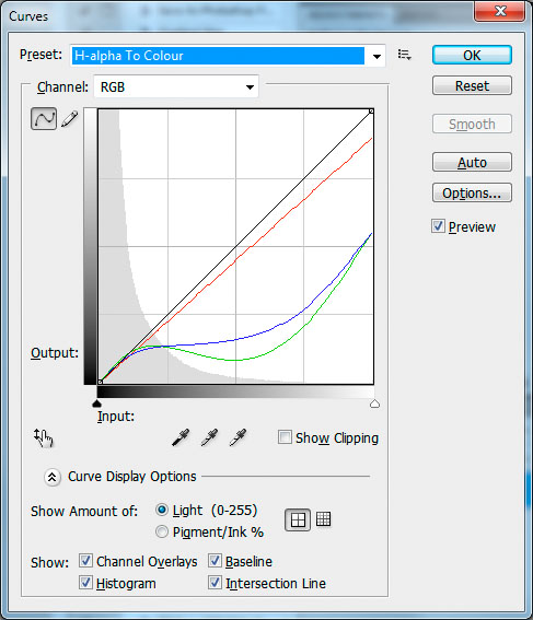

Here's my current starting point for conversion of a monochrome image just after selecting RGB mode:
I find I still have to fine tune the curves for some images but this crop pretty much covers the whole tonal range and, from memory, was pretty much using that set of curves straight out of the tin.:
My initial idea was to add blue to simulate Hβ but the without the green I found the result unpalatable so, as Hβ isn't too blue, I rationalised the addition of the green. The idea behind equal red, green and blue for the lowest signal was a rather bizarre attempt to mimic the eye's lack of colour vision at low intensity but I'm finding that the effect doesn't work too well so I think I may ditch it in the future. But I do like adding more green and blue at high intensity as I find the whiter look more intuitive when things get really bright. I tend to go my own way on this so, again, if you Google you should find plenty of more conventional recipes.
