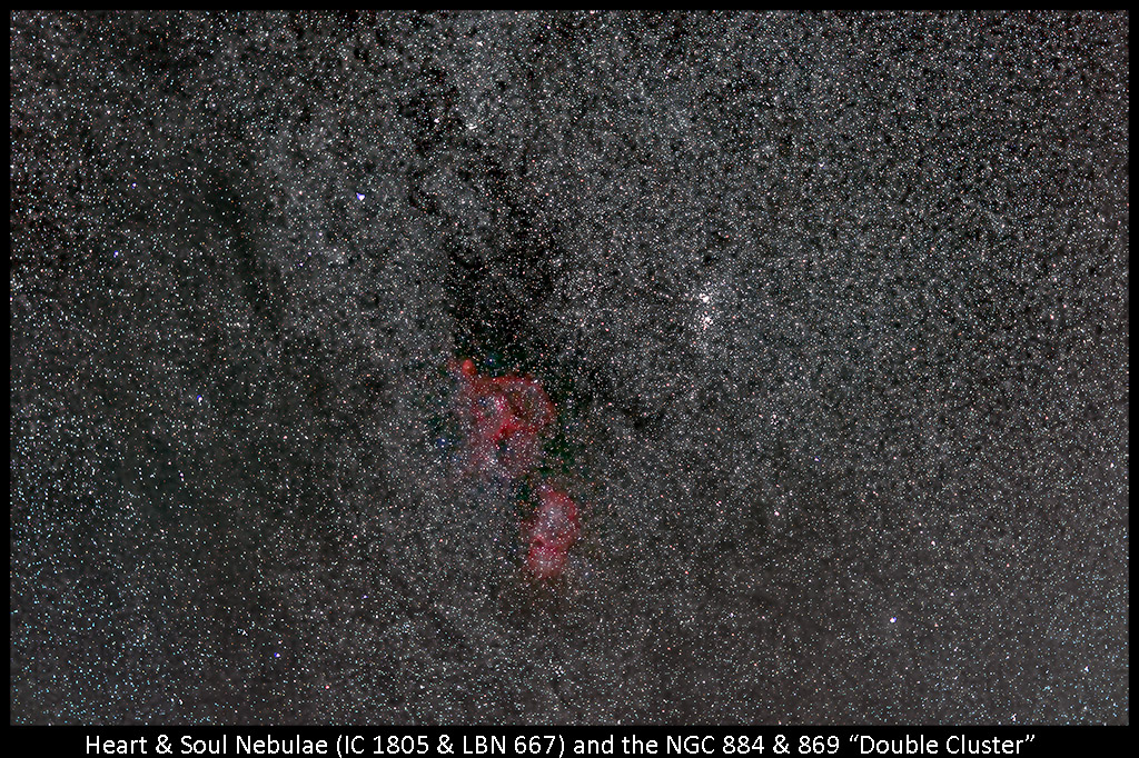

After what seems like forever the weather gods smiled last night, although the smile was slightly cynical as it turned misty at about half past midnight curtailing the session slightly. Anyhow, I managed to capture 18 "lights" of 2 minute exposure each with my 5D2 at ISO 400 and my 85mm lens wide open at f/1.2. An IDAS light pollution filter was used in front of the lens.
I commanded the 'scope to point at the star HIP11932 (nondescript but in the right direction) so the camera, which was piggybacked on top of the 'scope, was also pointing in that general direction. It lies roughly on the border of the constellations of Cassiopeia and Perseus. Very difficult to pull the emission nebula out of the murk so the image is rather over-processed but here's what I found.

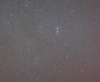

For comparison here's a thumbnail of one of the 2 minute exposures as delivered from the camera with no extra processing apart from a crop (the two crops are not the same):
The open clusters are easy enough to spot but there's the barest hint of the nebulae.
These are Wiki entries for the main features in the image: Heart Nebula, Soul Nebula, NGC 884 and NGC 869.

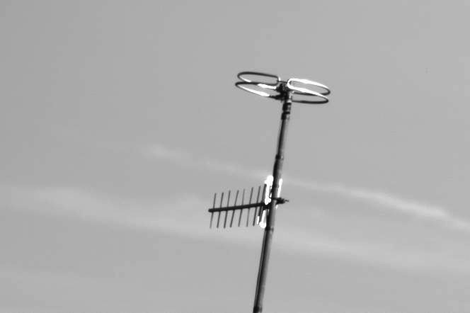

Actually I'm sort of serious. I've finally got my new astronomical camera (FLI ML16803) and filter wheel mounted up and while I'm still waiting for the new telescope there's no reason not to press ahead with the "Big Sky" side of the equation so I took a "first light" image during the day to check that I could actually reach infinity focus with my Pentax MF lens and that I understood enough about the hardware/software to actually capture an image! This is a 100% (664x442 pixel) crop from near the bottom left of a 4096x4096 pixel image taken with the CCD cooled to -25°C and an exposure time of 7/100ths of a second at f/2.8 through my Pentax 165mm 6x7 medium format lens. A 3nm Hα filter was in train to cut down the light intensity and even so I only just made it without having to stop the lens down! :shock:
So now I know the kit works it remains to get on with the serious business of using it at night. Hopefully with stars to work with I can improve the focusing slightly, using software tools designed for the job, especially as the shot above was taken through the conservatory window!!!

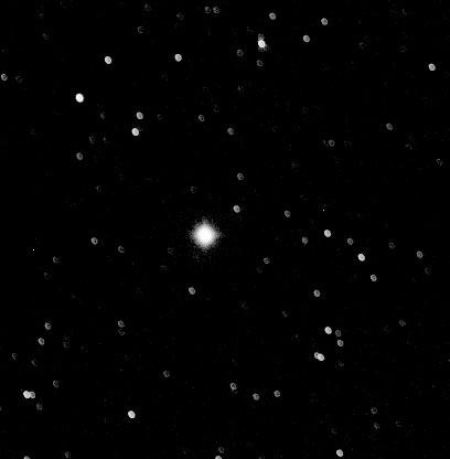

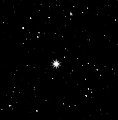

Darn it, or words to that effect. With stars in view, which are slightly further away than the TV aerial I showed a couple of posts back, this is what I got from a central 100% crop from a 10 second exposure at f/2.8 of Deneb with the Pentax lens hard up against the infinity stop:
The left hand image is at f/2.8 and the right hand one is a 30 second shot at f/5.6 with a less than attractive diffraction pattern around Deneb caused by the iris. :roll: These are just single exposures with no dark, bias or flat frames applied.
Close, but no banana, and backing the focus away from the infinity stop even by the tiniest amount just made it worse. The shot at f/5.6 showed how close the adaptor was to being perfect but close isn't good enough, unfortunately. I'm going to have to get Precise Parts to honour their guarantee and fabricate me a new adaptor. It will get done but by the time it does and then having to wait for the Moon to wane again I think that's my last chance at the North American nebula this year.
But even if the focus hadn't been out I would still have been stuffed as the clouds rolled in before I could have got properly going with my planned session for the evening. :evil:
