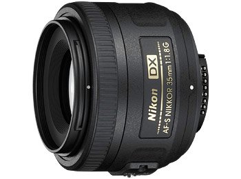

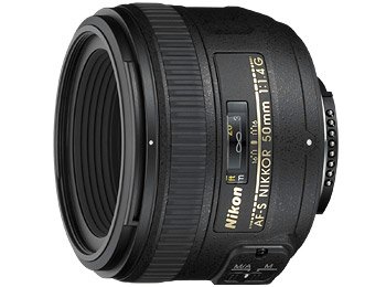

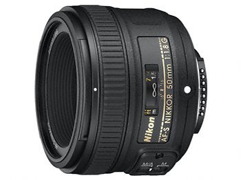

Now, let's have some side-by-side comparison of the new AF-S 50/1.8G, the DX AF-S 35/1.8G and the AF-S 50/1.4G
Image Image Image

35mm/1.8G: Size 70x53mm, weight 210g, filter-thread 52mm, street-price* 180EUR (DX-only!)

50mm/1.8G: Size 72x53mm, weight 185g, filter-thread 58mm, street-price* 190EUR
50mm/1.4G: Size 74x54mm, weight 280g, filter-thread 58mm, street-price* 330EUR
