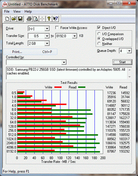

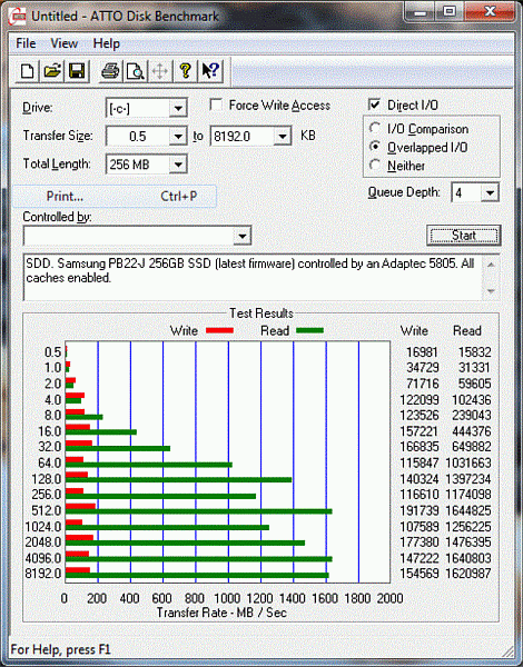

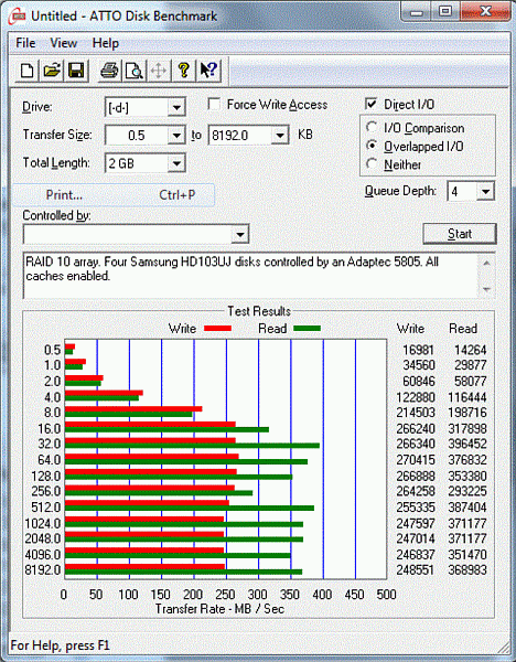

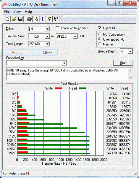

In addition to the CrystalDiskMark results posted above I decided to run the ATTO Disk Benchmark. I ran two test for each disk, the top pair being for the SSD and the RAID 10 array with the benchmark's default settings, in particular the 256MB length. The bottom pair were the same tests repeated but with a 2GB length to gain a better handle on how the Adaptec controller's cache was affecting the results.
      Total size of the data file that is created on the test drive = 256MB
      Total size of the data file that is created on the test drive = 2GB

Now you know as much as I do about what the test did. But I'll still have a go at interpretation - if I get it wrong I'd be grateful for any posts that put me right. :twisted:
I think the two pairs of tests successfully demonstrated what a huge affect the Adaptec 5805's read cache can have on performance, when the data needed is already cached, with transfer speeds of over 1.6GB/s, a figure which I believe reflects the speed limit of the PCIe x8 bus used by the 5805. Note that, if it does what it says on the tin, with "Direct I/O" used for the tests, this is not data that has been cached by the Windows buffers. The controller only has a total of 512MB of memory and some of that will be needed by its own processor so my assumption is that the 2GB transfer length gives a more accurate reflection of how speedy retrieval of data not already cached can be.
A read speed of 350MB/s from the RAID 10 array is certainly not shabby and, given that a single drive on its own is capable of a "Data Transfer Rate / Media to/from Buffer(Max.) of 175 MB/sec" and a "Data Transfer Rate / Buffer to/from Host(Max.) = 300 MB/sec" (source), I think it's fair to say that, with the help of the predictive read cache, the Adaptec 5805 is pulling required data as fast as the HDDs in the RAID 10 array are capable of providing it and that in the unlikely event I needed more performance the Adaptec controller wouldn't be a bottleneck.
I believe the benchmark may not be fairly reflecting the access time of the SSD, which is of the order of 40 times faster than the array according to HDTach, so I'm happy with my decision to configure the SSD as the boot drive and to use it to host Windows 7.
The write speeds are pretty consistent between the two pairs of tests but clearly show up the limitations of the SSD drive both in terms of speed and also variability.
So, finally dragging this post back into direct relevance to the thread, I think my case is made that motherboard based RAID solutions may be cheap but they can't compete in speed terms with dedicated controllers. I can't comment about reliability until I see a spurious error from the Adaptec 5805 of the sort I was regularly starting to get from the motherboard controller, an event I certainly hope doesn't happen and, to be fair, an event I actually don't expect to happen given my experience with previous hardware. I think it's finally time to stop hand-wringing over this, conclude it was money well spent (I'm lucky I could afford one) and start getting productive again... :wink:
