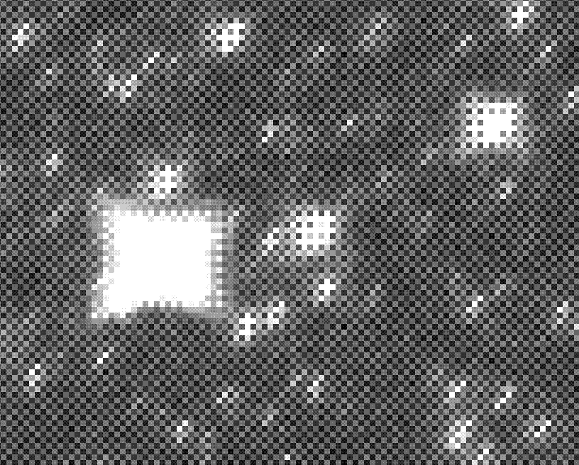

...Quick question concerning the star images. I noticed in your (and my own) long exposures that star images can often look quite electronic, and sometimes almost square-like. I realise the actual pixel locations on the sensor are smaller than the spread of the star using our optics and atmosphere, but wondered what your take was on this.
Interesting question - long answer! As you know CMOS sensors, such as are used in my 40D, are supposed to be immune to the "pixel bleeding" that some CCD sensors suffer from along their "rows".
This phenomenon of "square stars" affects the brighter stars in my images and can be seen in both the processed RAW and original JPEG files. This can't be put down to atmospheric "seeing" as that would tend to create round stars. One of the nice features of the IRIS software is that you can read the camera's RAW files using 1x1 binning. Here is a much magnified portion from the centre of one of the original images.
The biggest difference between this and the processed images is the way the processing has converted the square stars into squares with longer diagonal "extensions". As for why the bright stars are square this seems to be referred to in the trade as "crosstalk". Here is an example of the way sensors are constructed, courtesy of Fuji Corporation.

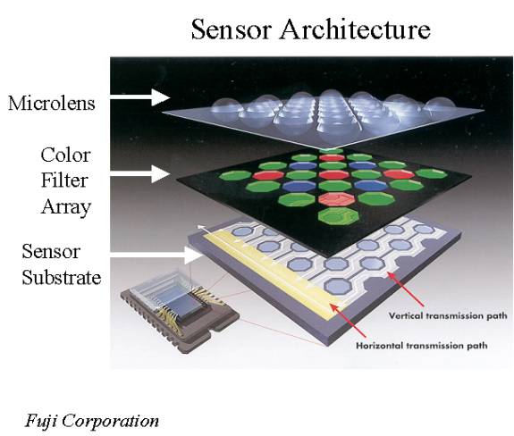

If some light is scattered by each microlens then it can find its way across to other microlenses and hence to the adjacent pixels. My take on this is that the proportion of scattering from microlens to microlens adjacent in the horizontal, vertical and diagonal directions is such that the resultant "shape" is likely to be square. If the incident light isn't white then not all of the sensors in the Bayer matrix will respond to this scattering and that is nicely shown in the largish bright star in the upper right corner of my image above with its lattice like structure. Of course, once the image is de-mosaiced this lattice structure disappears.
As with so much information on the Net, figuring out the correct search string is key. Once I realised that doing a Google search for "microlens crosstalk" was the way to go things became much clearer. In particular, I like the article Crosstalk challenges CMOS sensor design. This also addresses the issue of electrical crosstalk.

Nice article but no explanation, why crosstalk would have a square proliferation pattern.
But apart from the geometric shape of crosstalk, it certainly influences resolution tests, as they are built on measuring contrast. So "bleeding" from bright areas to dark zones in a resolution-chart will reduce contrast and thus resolution.
On the other hand, if you know the parameters of cross-talk for a certain sensor you could compensate for it. And if you only subtract a little from cells surrounding a very bright photo-well. That is how every contrast-improving algorithm works.
What astonishes me more in the large 1x1 binning pic is that many small stars seem to leave a diagonal imprint: one bright pix lower/left and one bright pix upper/right). That a tracking error of the telescope-mount?

Thanks for your feedback regarding lens testing and contrast enhancement. As for why the shape goes square (as opposed to cross shaped for example) I don't really know. The reason I included the illustration of the sensor is that it doesn't "feel unreasonable" that light can reach diagonally placed microlenses not only directly from the central microlens but also indirectly from the horizontally and vertically adjacent microlenses. The proportions obviously determine the exact shape.
Yes, I noticed the trailing you refer to running along the 45°/225° diagonal. Between exposures I stopped the mounting's drive motor for a few seconds each time and I can see the shift in stellar positions between each image. That orientation actually runs roughly along the 135°/315° diagonal. That means there was probably a misalignment of the polar axis, a task I have to do before each session, rather than a rate error in the speed at which the polar axis was rotating.
Assume the polar axis is misaligned by 1°. If I have my mental picture correct that means an image shift of 2° in 12 hours or about 1/3rd of a minute of arc every 2 minutes. From the picture the observed 2 or 3 pixels on a 40D sensor with an 85mm lens implies an error of about 1 minute of arc per 2 minute exposure if my sums are right. That implies a polar axis misalignment of about 3° which is disappointing as I would have hoped to be within about half that value. It ain't easy! :(
The misalignment is a shame because although this is only seen by pixel peepers it does imply a slight loss of sensitivity to the faintest stars.

Normally with a rectangular geometry of the photo-sites the directly adjacent cells should get the highest crosstalk and the diagonally adjoining cells only less. So normally you'd expect a circular proliferation pattern of crosstalk...
Btw. If you want to test crosstalk with a stationary subject, take an LED of say 3mm diameter and shoot it with a 24mm lens from 24m distance. That should just cover one photo-cell :D
D810+assorted lenses
PostPosted: Wed Oct 24, 2007 10:07 pm
But if it isn't crosstalk (optical and/or electrical) what is it?
