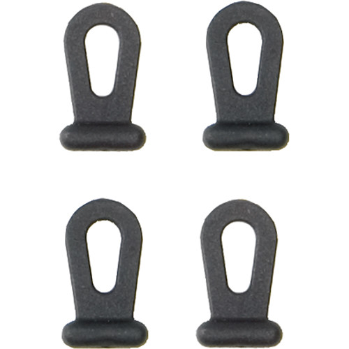

It is currently Sun May 19, 2013 4:46 am
 Post subject: New Strap for my D90
PostPosted: Mon Mar 23, 2009 6:27 pm
Joined: Tue Dec 23, 2008 3:18 am
Posts: 37
Location: MI
Ok spent a day out with my new D90 and the stock strap is GARBAGE!
I was looking for something that I could clip in and out (fast and easy) in the cameras strap mounts, but see many quick release designs still have the 2-4 inches of strap connected to camera (the quick release is mid strap level).
If I want the strap off I want to unclip it at the body, would something like this clip into my 2 strap holes on my D90?
http://www.bhphotovideo.com/c/product/3 ... l#features
I just like the idea of the end clip being easy to remove and not have a strap on both sides flopping around if I don't want the strap on the camera at that time.
Or is there a different end connector I could or should buy and use with any other "normal" strap I find that is comfortable but might not have that feature (just swapping out the end pieces for fast release).
Bill
My Boring Flickr Images
Last edited by FTLOSM on Mon Mar 23, 2009 6:46 pm, edited 3 times in total.
PostPosted: Mon Mar 23, 2009 6:31 pm
Joined: Tue Dec 23, 2008 3:18 am
Posts: 37
Location: MI
Just answered part of my question (finding these)
http://www.bhphotovideo.com/c/product/5 ... ifications
That looks like it would work for that style of strap to be used with my D90 strap slots.
Now to find a good comfy strap...
Bill
My Boring Flickr Images
PostPosted: Mon Mar 23, 2009 7:05 pm
Joined: Sat Jan 24, 2009 12:53 am
Posts: 281
Location: Coventry UK
It seems most strap slots are too small to accomodate a quick release clip. Another option to your plastic gizmos is to fix a key ring to each slot then a QR strap will attach easily.
Nikon D300 D80 D40 18-55mm 18-70mm 18-135mm 55-200mm 18-200mm 28mm 2.8f 50mm 1.8f 85mm 1.8f
Panasonic DMCFZ28 Slik Pro 700DX
I know a little about a lot, a lot about little and everything about nothing.
PostPosted: Mon Mar 23, 2009 11:53 pm
Posts: 3662
Optech actually does sell straps with a quick release built into the strap.
Graham
PostPosted: Tue Mar 24, 2009 9:29 am
Joined: Wed Jan 03, 2007 1:17 pm
Posts: 411
Location: Colchester - UK
grahamnp wrote:
Optech actually does sell straps with a quick release built into the strap.
I've got an Optech strap and have had it for nearly two years (including a trip around the world in all weather conditions). They are superb straps! Really comfortable and the quick release system is very nifty.
PostPosted: Sat Aug 15, 2009 2:42 pm
Joined: Mon Aug 10, 2009 2:28 pm
Posts: 25
Location: New York
I have used the Op/tech and Tamrac neoprene camera straps for the last 2 years.They are comfortable and have some stretch an flexibility to them so they absorb so of the weight of your camera, and they both have quick release claps
http://www.bhphotovideo.com/c/product/3 ... orber.html
http://www.bhphotovideo.com/c/product/3 ... Gray_.html
D90/70-300VR/18-105VR/50mmf/1.8 tamron 17- 50mm f2.8 ,FZ50 Sony HDR-HC9
http://community.webshots.com/user/pcg8 ... =community
PostPosted: Wed Aug 19, 2009 5:28 pm
Joined: Fri Sep 26, 2008 5:32 pm
Posts: 190
Location: California, USA
Is the remaining strap attached to the camera long enough for you to fold over as a grip strap? Because that's what I'd opt for.
Best regards,
Daniel
dmdesign
Nikon D80 ยท Nikkor 50mm f/1.8 AF
Sigma Foveon sensor fan... future owner, promise!
flickr me!
PostPosted: Wed Aug 19, 2009 7:28 pm
Joined: Fri Jun 01, 2007 12:40 am
Posts: 1330
I also have an Op/Tech strap connected to my D80 and I wouldn't be without it. When I use my tripod I simply release the strap and reconnect the remaining dangly ends to make a short hand strap which doesn't catch the wind quite so much.
zorro 8)
http://zorrofox4.deviantart.com/
Various lenses, SB800 & Manfrotto 190 with 460MG head
