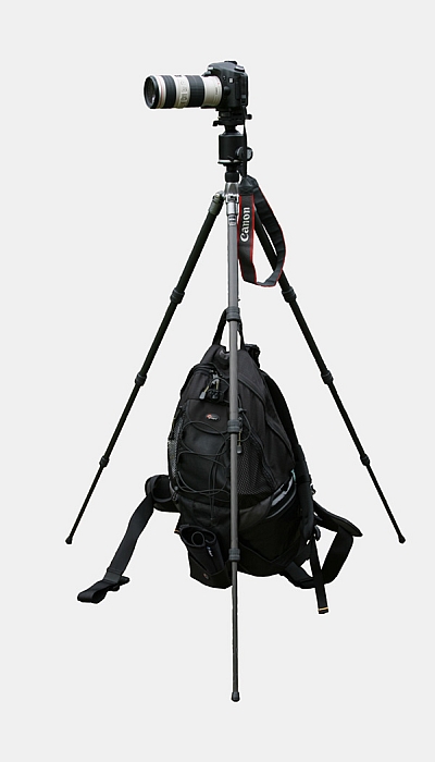

The light weight and compact dimensions of the GT1541T tripod when folded mean that, even though it uses the latest carbon fibre technology, it can certainly benefit from any extra stability on offer when in use. As the last photograph above shows, the centre column has the usual hook which can be pulled down and from which a backpack can be hung.
Whether stability is overly compromised we will see shortly but the next two photographs clearly show the benefit of it's compact size. The backpack is a LowePro DryZone Rover. Please note that the bag over the ballhead is not supplied by Arca-Swiss and is just a cheap lens pouch to provide some minimal protection from the elements when hiking.
