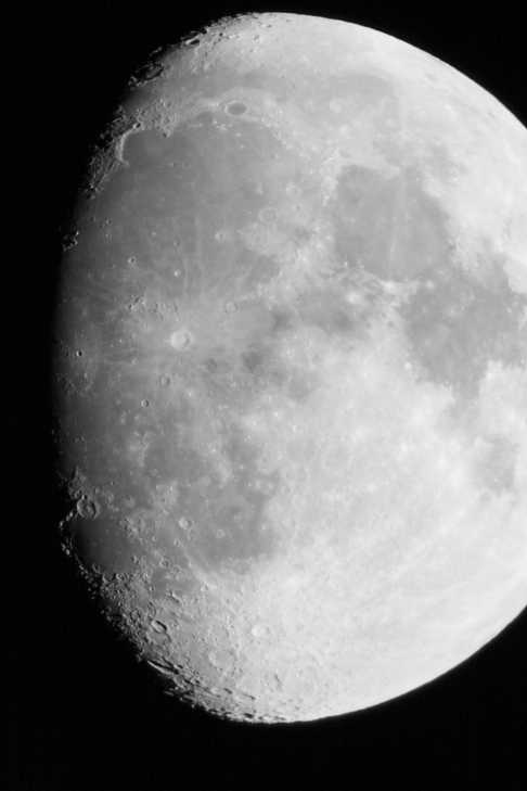

The first clear night for quite a few days here so I took my first opportunity to shoot the Moon with my EOS 40D at the telescope's prime focus.
Natively, the telescope has a focal length of 480mm at f/6.8 but I used a Powermate™ 4x "extender" to achieve an effective focal length of 1920mm at f/27.2. I had the 40D hooked up via an USB link so that I could control various shooting parameters from the notebook and also view each shot on a big screen as it was taken. In contrast to the technique described in my post First Light with the Canon EOS 40D this time I found it easier to focus using the camera's viewfinder.
The following shot is uncropped and was taken at ISO 800 with an exposure of 1/40th of a second. Mirror lock-up was enabled to reduce vibration and the shots were triggered using a remote release for the same reason. Post-processing was done using Canon's DPP program. The image is clickable if you want to download the 5.4MB full size picture.
Yet again the 40D has shown how flexible a tool it can be. Though I chose to focus conventionally using the viewfinder I checked out the result using the EOS Utility's Live View Preview mode. That graphically illustrated how poor my choice of location was as with the Moon fairly low to the horizon and between two buildings it was dancing around all over the place. At least using ISO 800 allowed a reasonably short exposure time of 1/40th of a second in the hope of capturing an image during a brief moment of steady seeing. Ideally a bigger telescope objective than my Pronto's 70mm would solve a number of issues but as prime focus astrophotography isn't my main interest I will be content with what I have.
It was an interesting first effort but I need to wait for a couple of months before trying to improve. Then, here in the Northern Hemisphere, the Moon will be a lot higher in the sky and I can avoid the thermals surrounding the buildings and the generally poor seeing associated with any object fairly close to the horizon. Then I can hopefully reduce to ISO 400 and maybe get away with 1/30th of a second exposure. Then it will just be a matter of taking a long sequence of identical shots in the hope that one may capture the Moon during a brief moment of clear seeing. Then maybe I'll find out if the slightly soft image above was down to poor focussing and/or poor seeing or a more fundamental optical problem with my set up.

Hi Bob, impressive shot! I'll be posting some Lunar shots with the 40D soon, but I didn't achieve anywhere near the same focal length! The Powermate 4x - is it a 1.25in or 2in design? If the former, were there any vignetting issues?
PostPosted: Sat Sep 22, 2007 11:12 pm
Posts: 9883
Thanks for the kind words. My Powermate is a 2" diameter unit. On the Pronto the "gotcha" was that the focussing rack didn't extend out far enough so a 3" long spacer was needed (at extra cost) to put the Powermate at the right distance. Then, as usual with my prime photography, the camera had to be behind a 2" spacer to achieve focus. Having the camera on such a long lever can't be good for the telescope's focussing rack and a few trial shots without Mirror Lockup enabled set the whole thing vibrating nicely. :(
The 40D was the class act of the optical train. With hindsight the 4x Powermate is pushing the envelope a bit far with my little Pronto. It might have been better to go for the 2x unit and accepted a smaller but brighter image of the Moon.
PostPosted: Sun Sep 23, 2007 12:42 pm
Hi Bob
Regardless what you mentioned about poor focusing or seeing..
I still think it was a very nice picture..impressive as Gordon put it.
