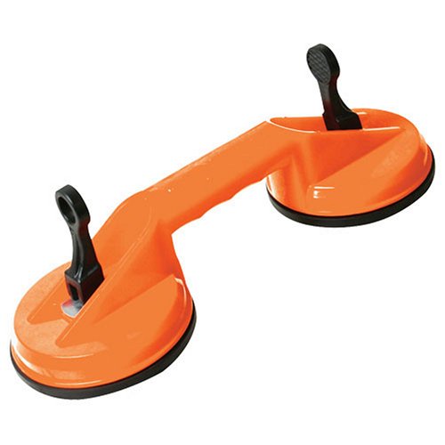

Shutter speed of about 1.3" -- the car is being pushed at 1-2mph. :lol:
I made the rig myself. It consists of 4 suction cups that were originally designed for carrying panels of glass!
Image Image Image Image
I then attached a Manfrotto Magic Arm onto the end of the pole and walk along holding the camera steady whilst firing it with a remote. :)
It requires a wide lens to fit the whole car in. For daylight shots I also use two ND8 filters on my EF-S 10-22mm. :)

I'm going to be doing this very soon, i've already brought two of these...
cant go wrong with £6.12 & Delivered FREE in the UK from amazon...
http://www.amazon.co.uk/Silverline-6750 ... 347&sr=1-2
I just need a very long light alliminuim pole and some way to attatch the camera on the end.
Where did you get yours from??
